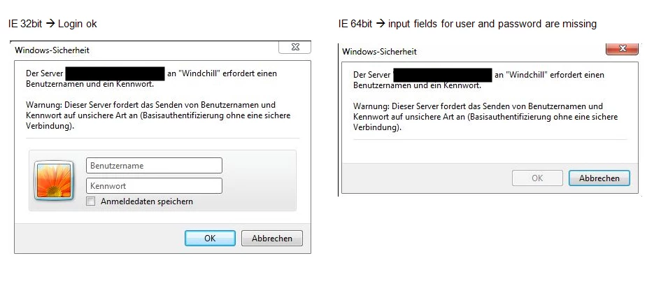

has anybody seen this issue before:
PDMLink-login with IE32bit works
PDMLink-login with IE64bit fails because input fields are missing.
Sorry, attachment is in German but I think you can see missing input fields for user and password.
Thanks, Jochen

There are a million reasons not to use IE 64 bit and none of them relate to Windchill. One of those reasons could be why you are seeing this issue.
LINK: http://support.microsoft.com/kb/896457
"The x64-based versions of Microsoft Windows Server 2003 and Microsoft Windows XP Professional x64 Edition include a 32-bit version and a 64-bit version of Microsoft Internet Explorer. Both versions of Internet Explorer are included to increase compatibility with existing programs and Web sites. The 32-bit version of Internet Explorer can host only native 32-bit ActiveX controls and other 32-bit Web page objects. The 64-bit version of Internet Explorer can host only native 64-bit ActiveX controls and other 64-bit Web page objects.
This article describes the differences between the 32-bit and 64-bit versions of Internet Explorer that are included in the x64-based versions of Windows."
