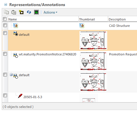

Hi All,
We have recently updated our approval process to include publishing a viewable at a state change as we have the status (In Work, Under Review or Released) in our drawing border. This means that if, during the approval process, annotations are saved, they are not visible on the "default" viewable (screenshot from the "Content" tab in Windchill below):
I can manually go into this tab and select the version with the annotation to be the default (last in the list above), but this is onerous. Can it be set to occur automatically, somehow? Is there a line of could that runs an if function to search for an annotation? In terms of code, we currently have the following additional variables to permit our publishing process:

Hello
Sorry, I do not have a straight answer but instead a question 😮
If you manage to automate the Set Default annotated view you take the risk that the life cycle state can be wrong.
If the view was created before a change state this will be the case. Your annotated view is not automatically republish and if so, are the annotation kept ?
I would test this before making the change.
I see a potential risk there.

Jul 8, 2015 8:53 AM UTC
Hi Chris. That's a good shout. The annotated drawings remains at "Under Review" whereas the rejected viewable reads "In Work". I'll manage it with appropriate user guidance. Thanks!
