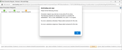

@DK_11085982 and @ES_11249468 ,
You can do this with a form delegate. The delegate is just a Java class with the appropriate code to get the job done.
It runs when the user hits the "Finish" button. Simple to setup.
In short, the Java code runs when you hit the Finish button during the Promotion Request creation.
The custom Java class delegate that I wrote does 5 checks including checking for at least one participant in the mandatory roles.
Currently the checks include:
1. If the creator has added himself/herself to any restricted roles, for example Approver or Review. No one should be the Approver or Reviewer for Promotion Requests that they create.
2. Do all mandatory roles have at least one users.
3. Are any of the promotables already on an active Promotion Request.
4. Validates all promotables are in the same container as the Promotion Request
5. Validates the select workflow is in the same container as the Promotion Request
The code can be edited to do whatever is specified.  It's just a matter of knowing what's required.
If any of the checks find a problem, the user cannot create the Promotion Request until the problems are fixed, and a window is displayed to the user stating exactly what the problems are.
The idea is to fix everything BEFORE the Promotion Request is created and the workflow started.
Here's a screen shot showing the errors.  In this case I'm creating a Promotion Request that has an object that is already on an active Promotion Request and I have neglected to specify Approver an Reviewer.
You might consider a second delegate to run in when editing a Promotion Request.
The edit delegate/class I wrote checks two thing.
1. Are any of the promotables already on an active Promotion Request (other than the one being edited of course).
2. Validates the promotables are in the same container as the Promotion Request
If any of the checks find a problem, the user cannot edit the Request and a window is displayed to the user exactly what the problem is.
6-Contributor
Nov 4, 2024 6:27 PM UTC
This is exactly what I'm looking for! Would you be willing to share what your code looks like here? I'm very new to Java and I don't know how I would se5t up these delegates.
