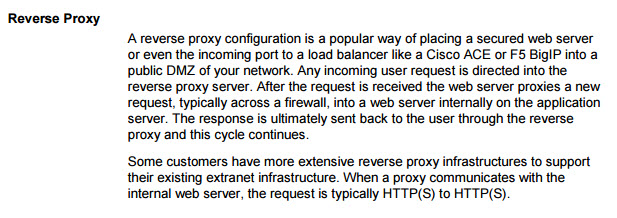

Dharmendra - Looking at your add-on questions, it seems that you are wondering if there is a need to have a separate Apache server acting as a reverse proxy (distinct from the Windchill Apache server). The answer is yes. With a separate Apache server (reverse proxy configuration), you can have external users connecting to the reverse proxy (through the DNS) and internal users connecting to the Windchill Apache server (using the native wt.server.codebase URL) without going through the Reverse Proxy.
As underlined by Binesh, you can create your own reverse proxy configuration with the Bundled PTC Apache Server (a separate instance) or any other Apache distribution and you can also use a Linux VM (CentOS, RedHat, ..)
Here is the definition of the Reverse Proxy extracted from the Windchill Architecture Overview (WNC 10.2) available at this link
The following CS68466 is an excellent way to start this reverse proxy configuration.
