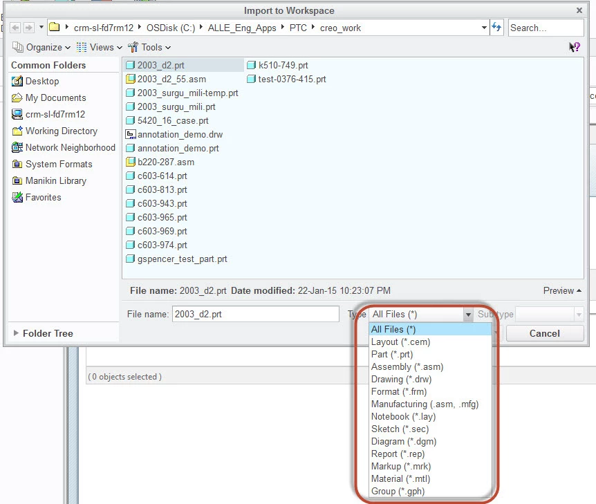

Managing Creo support files from Windchill 10.x
We are trying to consolidate out Creo support files into Windchill...
So, since I can't "import" them, I figure I would just 'add" them in as new documents. I'm not sure how successful that was as I used the "general" DocType when creating.
MY QUESTIONs - has anybody already done this? If so, what 'type" did you use when creating the wtdocs? Is there another way?
Any comments would be most appreciated.

    A couple of things to take note of here. There is a config.pro to add additional files to the import in the Creo WGM. Listed below are the ones we have added.
    allow_import_file_extension – bnd, tbl, ttf, sym, scl, dtl, pro, map, cfg, dat, win, pnt, dmt, mnu, psm
    !!!Allow additional files with extensions to be shown in the
    !!!import dialog
    Be careful here if you are using Windchill just as the storage of files or expecting Creo to use these on startup as well. There are a few that wont act like expected. Things that need to load on startup can be and issue. Tree.cfg, syscol.scl are a couple that come to mind. This is due to them noth being available until after you are connected to Windchill which is the last thing to happen.
