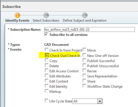

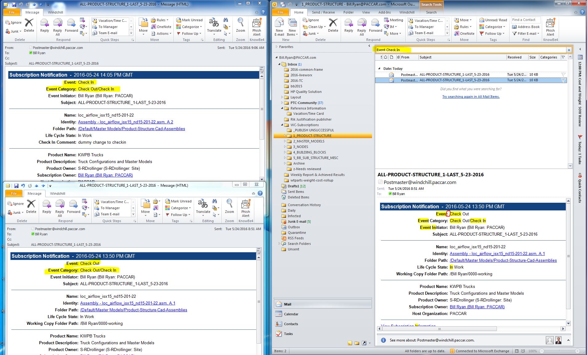

Is it just me, or has anybody else noticed that it is not possible to seperate out the emails for the checkout and checkin transactions using Rules in Microsoft Outlook?  How can I accomplish this?  I think I need the event category split up for the two transactions instead of having Check Out/Check In as one checkbox event.
I want to delete the Check Out transaction events or ignore them...it's the checkin that I want to be notified on.  Note: Outlook doesn't recognize the ":" in searches or rules.  There is no way to execute a rule based on "Event: Check In" which is the obvious solution to this problem.

Would a mail rule in Outlook using the "Specific words in the body" filter work? You could use it on the Event: Check Out or Event: Check In or even that custom subscription name loc_airflow_etc that you set on the subscription.

That was the problem Daryl...I was unable to search for words in the body because the formatting of the text in the email for "Event: CheckIn" and "Event: CheckOut" is not formatted correctly to be searched against. However, pictures are worth a thousand words!  I noticed checkout has unique words of "working copy folder path" that checkin doesn't have...this solved my problem.  It still doesn't take away the fact that I wish the events for checkout and checkin were two seperate check boxes in Windchill to be notified on.
