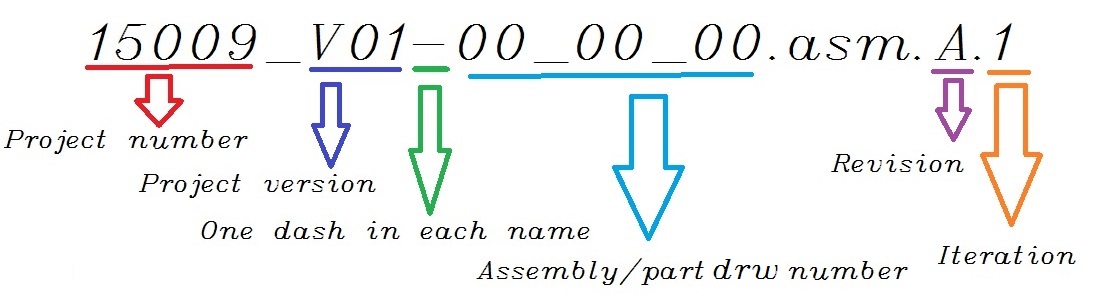

before 6 months we started Windchill 10.2 implemetation. After some time l have some basic problems with parts numbering. Will describe my situation and problems.
Present situation:
- before Windchill we had use following file name schema:
- each part and assembly includes "extract" function in relation ---> project number and drawing number is included in file name
- 00_00_00 ---> is some logical "model tree" schema ---> example: subassy 01_01_00  includes parts 01_01_01, 01_01_02 ...
- in praxis it means:
    assembly moved in model tree ---> rename parts and drawings
- l want keep this logic inside Windchill
Problem:
- during first stage of planing we are changing product structure (model tree) quite often
- Windchill is quite sensitive to rename from the reason of "Drawing  - 15009_v01-05_02_05_00.drw is not unique."
- SAVE AS copies does same problem sometimes
My ideas and solution:
- Do l need model number? ---> NO, because all informations are included in file name
- ignore model number ---> turn it to AUTONUMBERING
- will Autonumbering help me? Model number is only for Windchill internal functions, but l´m interested only in file name.
My unskilled imagine about autonumbering:
- Windchill will change model numbers automaticly ---> it will never occur "Drawing  - xx_yy_zz.drw is not unique"  or am l looking thrue pink glasses?
Thx for any help or tips...

For me is product and project the same.
Company CAD data management history without Windchill:
- company estabilished without any idea how to use ProEngineer (l´m the first employee)
- l think ORDER HAS TO BE ---> we choosed a file name schema 13009_V01-00_00_00
    - 13 --- year of project begin
    - 009 --- project number in this year
    - V01 --- version of project (we have many similar geometries)
    - "-" --- only one dash in each file name (dash is a relation separator)
    - 00_00_00 --- part or assembly drawing number
- parts and assemblies included following relations:
    IF CISLO_VYK_V_NAZVU==YES
    typ_oznaceni=EXTRACT(REL_MODEL_NAME,1,SEARCH(EXTRACT(REL_MODEL_NAME,1,(\STRING_LENGTH(REL_MODEL_NAME))),"-")-1)
    cislo_vyk=EXTRACT(REL_MODEL_NAME,(SEARCH(REL_MODEL_NAME,"-")+1),((\STRING_LENGTH(REL_MODEL_NAME))-(SEARCH(REL_MODEL_NAME,"-")+1)+1))
    ENDIF
    Explanation:
          - CISLO_VYK_V_NAZVU (english translate: DRW_NUMBER_IN_MODEL NAME) --- if set to NO, than the connection between file name is broken
          - typ_oznaceni (english translate: project or product) ---> result: 13009_V01
          - cislo_vyk (english translate: drawing_number) ---> result: 00_00_00
- it had worked great upto Windchill implementation
- it tooks me so much time to make so many decisions and inovations in this area without WCH, that l want to keep it (is it mystake or pink glasses?)
- l discovered this schema in some project from the year 1960. But als you said: "It is a time to inovation and start to think different way with WCH or any other datab management program. Simply because it is 21st century." l have no problem with this.
Company CAD data management with Windchill: (describes my imagination ---> l have pink and unskilled Windchill glasses )
- l wanna keep this schema ---> from your inputs l have started think if it is a good choice?
- l have to choose something better from the reasons described above

My approach would be to look at what information is carried by the filename.  Does that information exist else where, If so, is it generated automatically or not
Aim for no duplication of the information
Can you see tools in Windchill such as searching, reporting, filtering that will work better using Out Of The Box functionalities of Windchill (Such as location or Attributes) than trying the same with filename.  How can you report on filename eg.  How can you quickly with Windchill find how many revisions of the same projects, Number of project generated in last 6 months,  project still open (uncompleted) number of finished projects, which one are late,  who is working on which project etc….
You will see that the information in filename should be irrelevant as you will get all that information from elsewhere.

Why renaming ? if you start from a template you are prompted to give a name a with a brand new object. Unless you mean that the template as a default name that you need to replace ??
- Otherwise, just ignore the number - it´s only used in Windchill.
This is an approach but this would not be using the tool correctly. Best practice is that PDM Number = ERP Number for instance, so better start with good practice to avoid having to renumber in the future.
As far as I and the PLM Think Tank I work with are concerned, things are/should be kept simple
WTPart Number = EPMDocument Number = ERP Number = CAD filename.ext
WTpart Name = EPMDocument Name = ERP Name/description
- Your part number should also be the same as your drawing number.
Here again, I do not consider this has good practice, If you take PDMLink
A model and a drawing are both EPMDocument and OOTB the system will not let you have both number,  Even if you could, what do you do when you have 2 drawings for the same model ?
Your part/product is represented by the WTPart, so at a minimum the wtpart should have the same number than your item in ERP.
You could have your EPMDocument for the model have a different number but for what reason , really ?  Then come your 2D representation. I purposely call it 2D representation and not 2D drawing as at the end of the day a 2D drawing is only a representation of your 3D model for a given purpose. You could have a need for several representations of your 3D model in 2D. So then how can you give the representations all the same number ?
I have followed the link you provided. I am glad to see that you do not content yourself with this forum only.
There are effectively two schools those who believe speaking/smart/talking/descriptive numbering scheme is the best and the other school which believe that only random/meaningless/sequential numbering scheme is the only good way.
My experience has showed me that generally those in favour of speaking numbers are engineers with a lot of experience in what they do and little in computer system and therefore want to use the system with the "old" way of working.
As Gregory said, Windchill is highly configurable so your number could be automatically generated by the system following rules that create a speaking number. However, you have discovered by yourself the limitation. This speaking number then means nothing when reuse in a different structure....
It is very hard to afford time and money to properly investigate and test all the pros and cons. The good news is that you can have an lean approach of the implementation and consider that your system will be going through a continuous improvement phase for many years. In addition Windchill is very flexible. As a consequence, you could start using Windchill and let your user manually allocate the numbers. You should not delay "too" much an implementation just because of a numbering scheme. Once you start using Windchill and getting other benefits and users more familiar with it, you can revise the numbering scheme.  I have in the past had to renumbered teens of thousands of WTpart, EPMDocument and filename. OK we tested it and prepared for it but it only took a few hours to do. The biggest problem was actually that some drawings were not calling the correct parameters for the Number, so when we made the change, it was not apparent on the drawing so we needed to include an iteration of the drawings to replace the parameter.
All this to say that there is no right or wrong way to go live. Go Live and you can always improve and make changes later. One thing though, whatever is decided for go live must be justifiable otherwise it will be said that it was a bad implementation etc.. When things start to go wrong month after go live, users are quick to blame the system or the implementor.
once again. All the best in your journey to perfection
