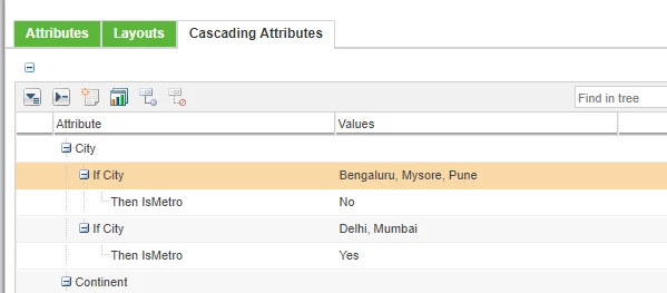

I have two attributes let's say A and B with some values, for attribute A of   I have selected value as "MH" then automatically B should show "IN".
Is it possible OOTB? If yes, how to achieve it ?

If it's more complex than that, you can also look into Calculated Attributes: https://support.ptc.com/help/wnc/r12.1.1.0/en/index.html#page/Windchill_Help_Center/typeattr/TypeMgrAttrFormula.html

I would say that this can be configured by cascading attributes
Check the help
Cascading Attributes
A limitation is that it can be configured only on WTDocument and WTPart type.
