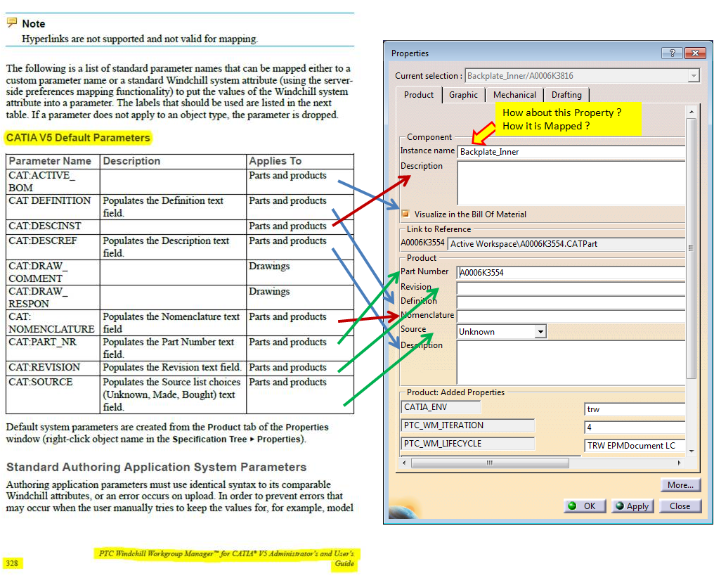

Hello all,
I am trying to understand, how to make use of below shown CATIA V5 Default Parameters to map with Part and CAD document in WindChill. Below image is from "PTC WindChill Workgroup Manager™ for CATIA® V5 Administrator's and User's Guide, PTC Windchill® 10.2 M030" document, along with CATIA File property Window.
Can anybody confirm,
1) if there are any constraints for mapping these parameters in to WindChill ?
2) Component Instance name is not shown on the list of V5 default parameters, still this parameter is mapped with Component name of CAD usage link and Reference designator of Part Usage link.
Appreciate any help on this topic from expert community.

Sep 1, 2016 3:42 PM UTC
Hello Satish,
Mapping CATIA instance parameters to Windchill IBA is not supported today. Please refer to CS218196.
However, as you pointed out, 'Component Instance Name' is mapped to 'Component Name' of in Windchill CAD Document usage link. In addition, when CATIA data is published, Creo View has CATIA instance properties ('Instance Name' and 'Instance Description').

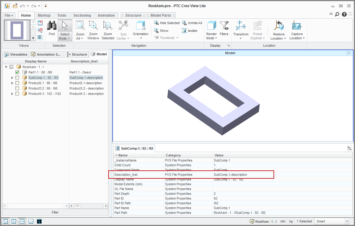

Sep 2, 2016 3:17 PM UTC
Mapping CATIA instance description to Windchill attribute is still not supported in Windchill 11.0. Instead, there is recent enhancement on Creo View Adapter to show the instance description as component property from Creo View. You can find "Description_Inst" from "PVS File Properties Category".
The Windchill 11.0 implementation corresponding to the SPR linked to CS218196 refers this change in Creo View adapter for CATIA V5. It is available from THEOREM CADverter 19.2.
Yoda
