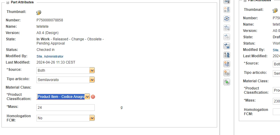

MAPS - How to propagate values specific attribute from upstream to downstream
how can I choose which attribute has to propagate their values from upstream to downstream?
I have few attributes those not propagate their value. where can I find the properties?
Many thanks

Apr 26, 2024 11:16 AM UTC
You can use mpmlink.properties file located at WT_HOME\codebase\com\ptc\windchill\mpml.
regards
~Syed
