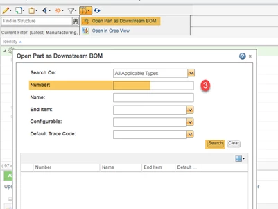

Regarding question 2 here is the procedure to remove the equivalence link :
  • Perquisite: add to container team the role " Manufacturing Engineering manager  " and assign your user (or the relevant group) to it
  • Open MAPSB
  • Open the part as downstream BOM (you can use part number)
  • No the "Remove all Equivalence Link" will be ungrayed, use it to remove this undesired equivalence link
I hope this can help you.

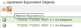

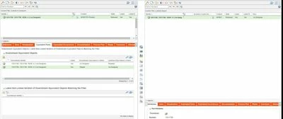

Thanks, I think we can do the same thing (let me know if not) by selecting the part in the upstream panel, then within the same left side view on the Equivalence tab,  select that downstream equivalent part (that we don't want) and display in Downstream panel, then within the same right side panel on it's equivalence tab select the part and use the icon to remove equivalence link.

Hello Igrant,
Indeed you can do it this way.
My suggestion was regarding the deletion of all equivalent links for this part and recreate them as they seem to be not correct.
