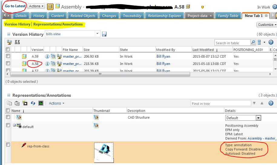

I don't have a solution to the URL problem...but have you thought about enabling copy forward so the markup is attached to the latest?  I am able to open the annotation set from an older iteration when active in the information page (customized to show version history and reps)...maybe you can get the URL from this page to help reverse engineer what you are doing.
