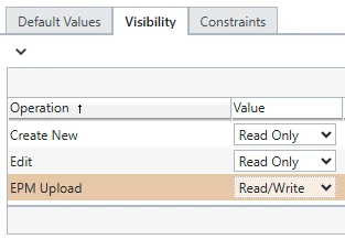

Oct 24, 2025 7:03 PM UTC
I haven't tried this in many years.  Last time I set up gatekeeper, we defined visibility of the ModelCheck attributes in Windchill as Read Only.  That way they could only be driven from Creo during upload.
Create New = Read Only
Edit = Read Only
EPM Upload = Read/Write
If you really need these attributes mapped into Windchill, I would suggest setting them up so they can't be modified from the Windchill side.
