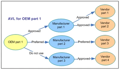

Use Case: Our customer has recently migrated from Agile PLM to Windchill and is looking for similar Manufacturing Change Order (MCO) functionality. Specifically, they are interested in understanding how Windchill handles scenarios such as: Attribute modifications Addition of AML (Approved Manufacturer List) parts …after a part has been released, without requiring a change in the part revision. Could you please confirm if such changes can be managed in Windchill without revising the part? This will help us guide the customer appropriately.

If you are looking for managing AML, look at the Supplier Management module. This allows for management of the AML/AVL without check in/out. It does not have a formal MCO but does keep track of changes to the entries.
https://support.ptc.com/help/wnc/r12.0.2.0/en/#page/Windchill_Help_Center%2FSUMA_PartRelationAbout.html%23
