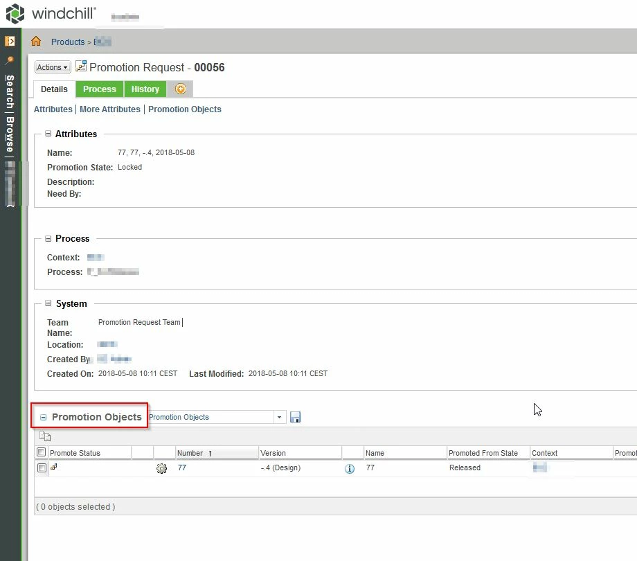

The MaturityServices provides methods to handle targets and seeds. Can someone explain the difference between both targets and seeds ?
In the Windchill GUI, I can only Promotion Objects are linked.

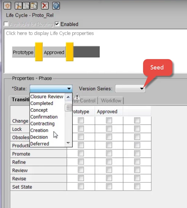

Hi ,
If I understand Correctly:
Target  = State
Seed = Version Series
 Two things you need to concentrate in Fundamentals of Windchill here:
 1. Lifecycle template : Basic LC template has States, Transitions and Version
**************" attached Screenshot"******************
2. Version Series
For StateBasedSeries scenario, you may want to create "SEED"
EnumCustomize
Start the enumCustomize utility from a Windchill shell with following command
enumCustomize
Navigate to wt > series > wt.series.SeriesRangeSelectorRB
Ensure that the Keys added, match the names of the seeds example (PROTOTYPE_VER, RELEASED_VER)  defined in StateBasedSeries.xml
Save and choose to rebuild the source
Rebuild Jars
Restart Server after clearing cache.
Cheers
Rahul

Thanks for your answer, but it is not correct. "Promotion Targets" are the objects (WTPart for example) that are handled by a Promotion notice.
Regards
Loïc
Jun 4, 2018 1:52 PM UTC
Yes Correct
Promotion Targets = WTPart/WTDocument/EPMDocument
Target State = Destination LC State
SEED = Version Scheme
