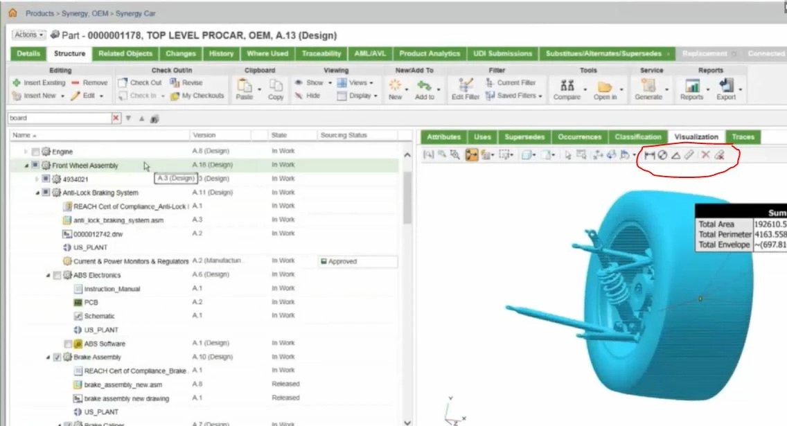

Hi everyone,
While watching a PTC webinar I saw that in the structure visualization panel in Windchill there are measurement commands (see image 1).

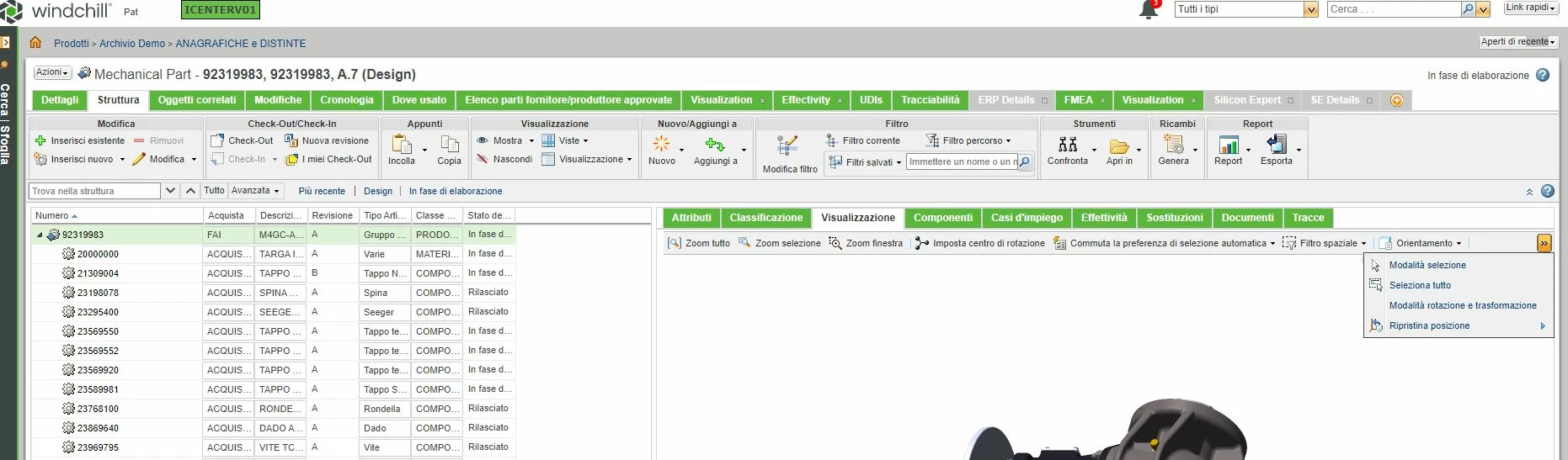

I checked my system (version 12.1.2.5) and I don't see them(see image 2). How can I add them?
Is there a property or preference to set?

How old is that webinar?
https://support.ptc.com/help/wnc/r12.1.1.0/en/index.html#page/Windchill_Help_Center/prodstructure/PMVisualizationTab.html#
The note says that measurement is only for Creo View, not the webgl plugin.

I think the webinar is from 2021. So unfortunately, from what I understand, the feature either doesn't exist or has been removed. Thank you, Matteo.
