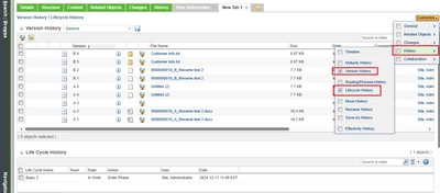

Is there a way to export all the the life cycle history tables from a given object type?  I want to see all the state changes and when they occurred from all of a given object type.

You could build a report using query builder. Just link the Object you care about to the Life Cycle History table. Example:
Just keep in mind, if you don't add any additional criteria, this will be a massive report.

In larger companies, Even Windchill admins do not create the Report (Templates Technically). You need to ask your Windchill Solution Owner. Typically a leader from your business team who owns the solution (delivered from your IT).
Windchill admins, though extremely knowledgeable, needs a CR to work on stuff like these. Depends on how new capabilities are introduced in your company.
Technically, there is a solution as mentioned by Joe.
Cheers

I think the best you can do at the user level is to make a custom tab and in that tab display Version History and Lifecyle History. This would at least allow you to click on any iteration and see its Lifecycle History.  The page will instantly refresh to show to the selected iterations Lifecycle History, so it's a least user friendly.
Other than that, as @joe_morton mentioned, have your admin make a Report.
FYI, any admin worth paying should be able to do this.  If they can't you need new admin as it's pretty simple to do it.
