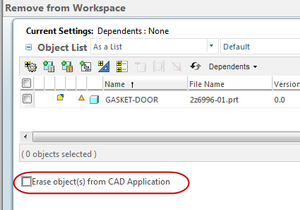

  4. Remove the CAD part from the workspace.  In the “Remove from Workspace” dialog box, uncheck the box for “Erase object(s) from CAD Application”

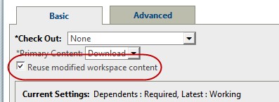

  7. Add all the parts into the workspace.  Verify that “Reuse modified workspace content” is selected.

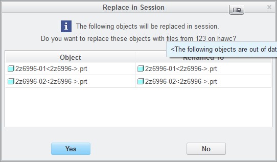

  8. Select Yes to Replace in Session the renaming of the objects.

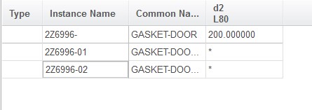

Adding a standalone part to a Family Table
  1. Name the standalone part to the new FT instance name
  2. Open the generic FT in Creo
  3. Create the new instance with same name as in step 1
    1. Set all to continue
  4. Remove the generic and instances from the workspace
    1. Uncheck the Erase object from CAD application

    1. Check reuse modified workspace content
  7. Select Yes to Replace in Session for renamed object
