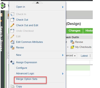

Hi community,
i have two Products Prod A and Prod B. Prod A is the Parent so it will be the TopLevelOptionSet Product B is the subassembly and is the LowLevelOptionSet. I`ve tried the https://support.ptc.com/help/windchill/r13.1.0.0/en/index.html#page/Windchill_Help_Center/options/OptionsMergeChoicesRules.html# and this https://www.ptc.com/en/support/article/CS367055

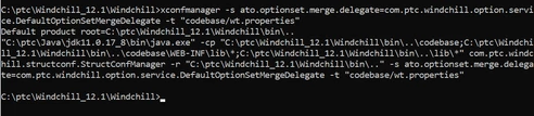

I used the shell command: xconfmanager –s ato.optionset.merge.delegate=com.ptc.windchill.option.service.DefaultOptionSetMergeDelegate -t "codebase/wt.properties" -p
which should enable in the detail tab when i go to Actions and Merge Option sets but it is not available for me, have i done something wrong?

on the site.xconf it looks like this
2.

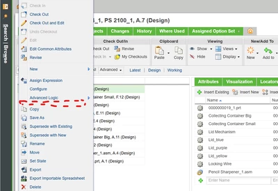

even it is on the site.xconf available i cannot see it in the Action menu

4. how it should look

The "merge option set" is only available for a user who is e member of the group "Platform Structures" (I think this is a licensing group).
Can you please check this and revert.
Cheers
Hari
Jan 24, 2025 8:12 AM UTC
is it possible with wcadmin licence?
Regards
Jan 24, 2025 9:41 AM UTC
Yes, It should work with wcadmin. Usually there is no restriction with wcadmin in terms of menu options / licensing.
