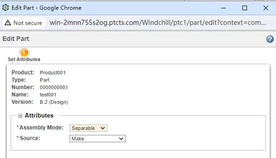

Good day
I am new to Windchill and I would like to find out how I can store and manage metadata relating to a part in Windchill. I am not referring to documents or Cad drawings etc.
For example, I have a part with certain values in terms of its performance, lifecycle, service intervals etc that is data not in a document.
How do I manage and modify these values in Windchill.

Rocket_Max
Jan 23, 2024 7:19 AM UTC
Hi @Markh74

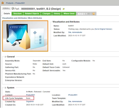

  • You can edit this part attribute via RMB

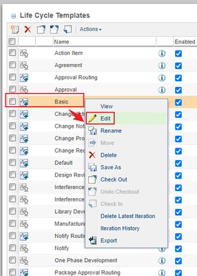

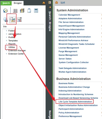

And change lifecycle via Life Cycle Template Administration
Article - CS377051 - How to modify a Lifecycle Template in Windchill PDMLink? (ptc.com)
I suggest you try your ideas while reading the help center
