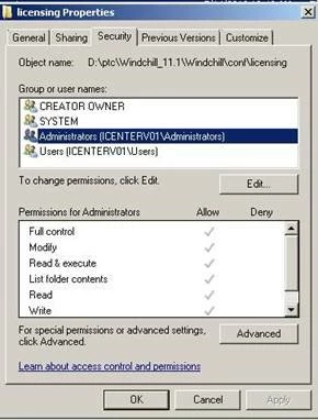

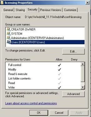

Please I need help, even with full permissions on Windchill folder the system is not able to read the license file. Below the full stack

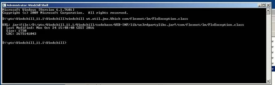

This FlexException class resides in wc3rdpartylibs.jar so possibly that jar may have problems.
windchill com.flexnet.lm.FlxException
This should give error like no main method found.
If yes rebuild these jars with below command from windchilll\srclib shell
ant -f windchill3rdPartyJars.xml all

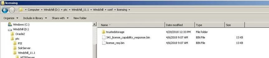

Beside the permissions, I would check if the CapabilityResonse generated is correct. Please try to get a new license file and check if that works.
I believe you have full permission on the location where the license file is located, do check if running the Windows process as Administrator helps.

Jul 19, 2018 7:19 AM UTC
Thanks Amit, we have already tried with a new License file but it didn't help.
Also Windchill is starting manually from the Administrator user of Windows. they don't have Windchill as Service.
