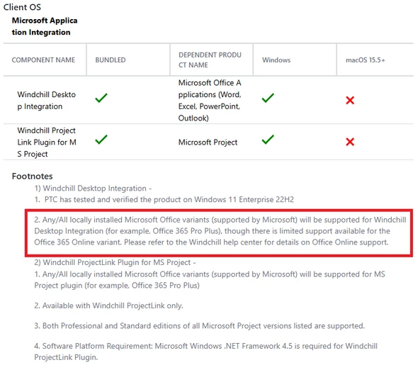

Microsoft Office 2019 is it supported OS version 2019 and 2022 and Windchill 13.1.2.0
Version: Windchill 13.0
Use Case: Currently i using windchill 13.1.2.0 version Based on creo view adapter 12.1.0 Microsoft Office 2019 , 2021 , 2022 ,2024 and 365 is it supported OS version 2019 and 2022 ?
Description:

Hi @SM_14152020
PTC Advisor should answer you question
CS196783 - Software Matrices of Windchill PLM
Product Release Calendar
Release Advisor - Windchill PLM 13.1.2.0 Release Matrix
So if the Office 2019 and 2022 are supported by Microsoft, then both versions should work.

Oct 22, 2025 9:10 AM UTC
Hi @SM_14152020
