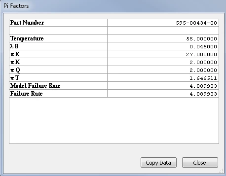

When using the MIL-HDBK-217 FN2 calculation model, each part has different Pi factors in the prediction data pane. How do I get these Pi factors that were used to print in a report? I don't see them in the list of available selections.
11-Garnet
May 14, 2018
Select Report:
(Common) Prediction Pi  Factors
