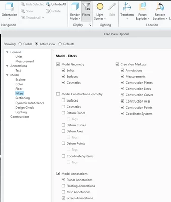

Send a screen shot of rcp file or listed of text file. Also, have you turned on all filters?

Jul 20, 2023 11:54 AM UTC
All Filters are on. I will check the RCP file.
