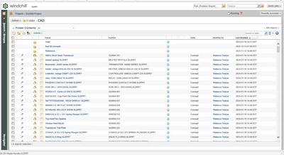

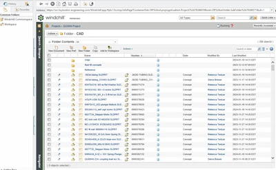

One of our users has reported her "open in Solidworks" icon has disappear from  a Project commonspace.  It's present in Products, just not in Projects.  Anyone ever experience this?  The first pic is how it usually looks, the second is what it looks like now.

Try this.
  • Please add the solidworks file from projectlink in workspace.
  • Open that file.
After opening , return to project link folder. You might have "Open in Solidworks" action available.
Please let us know.
January 19, 2024
Thanks.  We'll give it a try and will report back.
