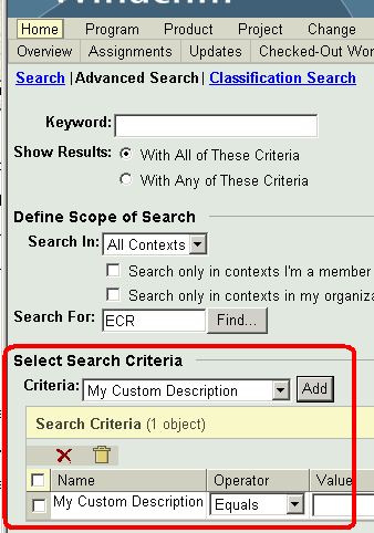

Run the following command from the Windchill shell.
<home>\Windchill>resourcebuild wt.change2.change2ModelRB
This will update the Advanced Search description display value, among
other things.
