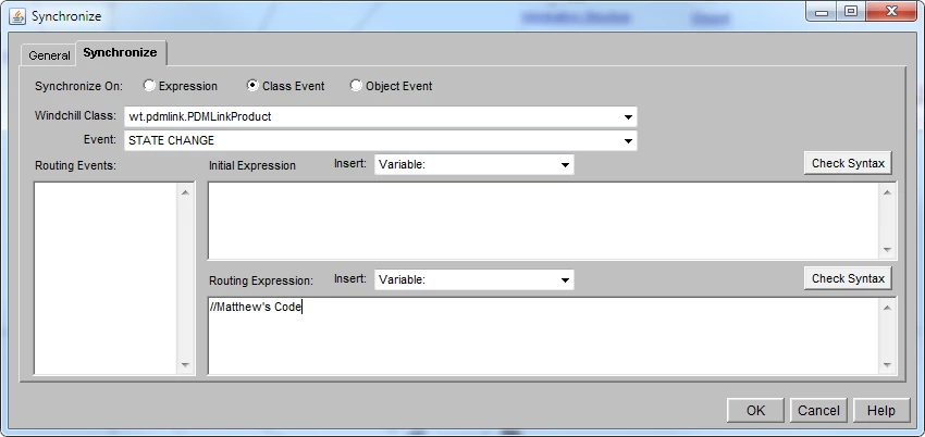

March 14, 2013
Hi Joseph,
Matthew's example covers the api to call in the workflow. In order to trigger Matthew's code
In your workflow :
  1. Use a 'Synchronise' object select the 'Class Event' radio tab.
  2. In the 'Windchill Class' down downselect the type of your primaryObject.
  3. In the 'Event' drop down select 'STATE_CHANGE'.
  4. In the routing expression use Matthew's code.
