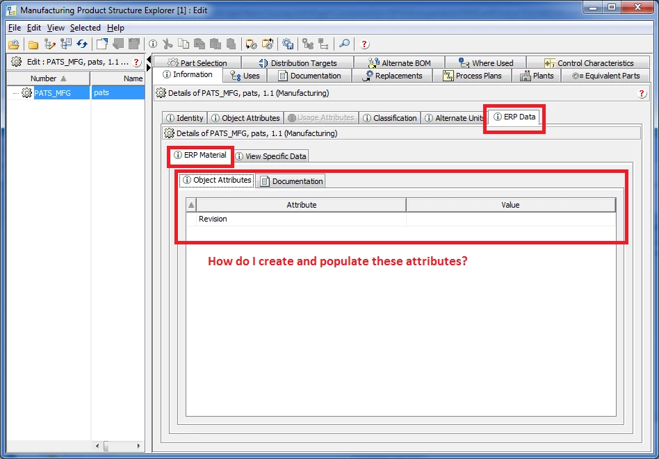

Has anyone in the MPMLink community been able to add attributes and values to the ERP Data->ERP Material section of a downstream manufacturing WTPart? I have read the WHC on this topic and enabled the preference but it still isn't working. This is 10.1 F000.

I've added some IBas ... but for testing purposes only. We finally do not use the ERP material on production.
Notably cause no iteration history on it.
But carrefull , the actual ERPMaterial is common to the whole "Branch" of WTpart , accros the equivalence links.
I mean that the ERPMaterial is the same intance objecton the Design View, manufacturing View and plant Views
When you revise the Design WTpart. it will create a new version of the ERPMaterial , wich will be visible/editable on all new revsions of your downstream WTparts (according to updated equivalence link)
It symbolize a kind of "SAP Material Master" which is the same for any BOM in the ERP ....
PTC R&D are in work for a quite deep change on the ERPMaterial data model for the future release of Windchill ...
regards

we've got exactly the same case as yours, with some make and/or buy Material
We choose to handle this in our Windchill to SAP interface, without using the ERP material
the most upstream View, generally the design View is sent as "Material Master" with its related Docs, drawings etc ... then it can be used for purchasing
the downstream Views and alternatives mBOM are sent to SAP with only BOM links informations (qty, unit , line number etc ...)
in fact we send 2 kind of messages to SAP:
-Material Master message
-BOM message
so it behavelike a kind of OOTB ERP Material as only upstream part/attributes/version is sent to ERP ..
