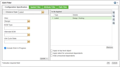

Please refer to the following screenshots:
  • Design View
Figure 1: Parent Part with 2 children parts
Figure 2: System Default filter showing upstream parts

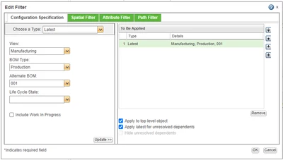

  • Manufacturing View 001 (Set 1)
Figure 3: Downstream parts created for TESTPART1 (Alt BOM 001) and TESTPART2 (Alt BOM 002) with filter applied for 001 only
Figure 4: Filter applies to 001 only

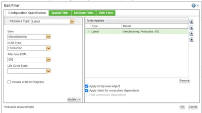

  • Manufacturing View 002 (Set 2)
Figure 5: Downstream parts created for TESTPART1 (Alt BOM 001) and TESTPART2 (Alt BOM 002) with filter applied for 002 only
Figure 6: Filter applies to 002 only
As you can see in these figures, the filter fails to filter out 002 in Set 1 and 001 in Set 2. Please inform how to proceed.

HelesicPetr
Jul 12, 2023 2:48 PM UTC
Hi @DW_10309702
I can see that you use just mfg filter and you apply this filter to the top level,
so the top-level part can not be resolved in this configuration.
I would suggest to add second filter for the design.
PetrH
