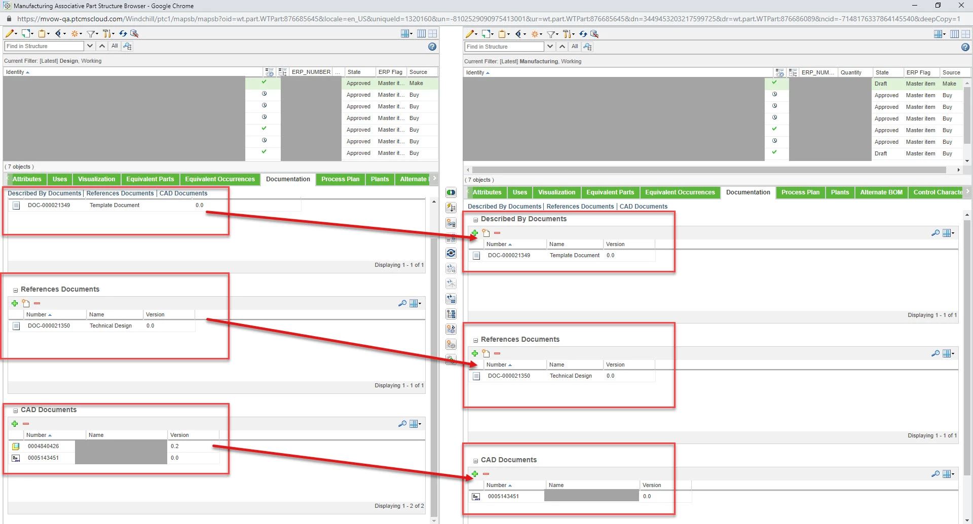

Is it possible to link the drawing from the upstream wtpart in Engineering View where the drawing is linked with calculated association to a downstream wtpart in Manufacturing View?
I've just started playing with installing MPMLink (11.0 M030 CPS16) to see if we could use it for MBOM, but I'm stuck with something probably very basic.
The idea is to build MBOM from EBOM, in MAPSB "New Downstream Part" is ok, that could be used, but what is needed to maintain the link to the upstream wtpart related EPMDoc drawing, which are associated with calculated links? What we want is to be able to fetch the engineering drawings through the MBOM structure, but is it doable?

Try the below attached Association Type for CAD & .DRW files.
With below Association Type when defined, it is possible to carry over all related documents, CAD files, and Drawing files from Design View Pane to Manufacturing View Pane.
Regards...!!!

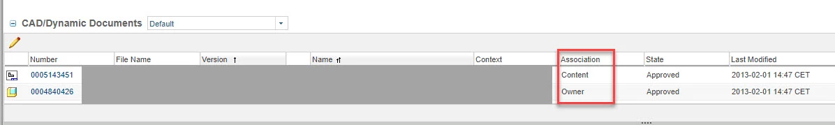

Confirms what I've tested, it's necessary that the association for the drawing & wtpart in Design view is "Content". That may be a bit of a problem as everything currently is with Calculated...
Seems that another way is to manually add the drawing to the wtpart on the Manufacturing pane which will add it as "Content" there while in Design pane it remains as "Calculated". Not so convenient.

Yes... it will not be a convenient approach when BoM structure is huge.
Make senses to have all relevant documents & CAD files associated with the Design View WTParts and them have them automatically propagated to desired Downstream View.
Saves a lot of time...:)
