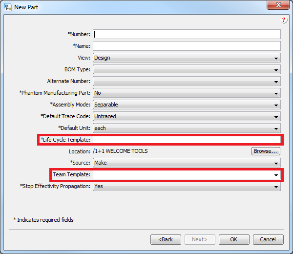

Hi Everyone,
I am really struggling with this issue and I cannot figure out why it is happening.  I have a soft type of WTPart called SCPart.  I have an OIR for SCPart at the Org level.  When I create a SCPart within the PDMLink UI, the OIR is read correctly and all attributes (lifecycle, team template, etc.) are filled in correctly.  However when I open the MPSE from a Product container and select File->New Part, the OIR doesn't seem to be read and the attributes are not filled in.  I only see blank textboxes.  Does anyone have any ideas?

It's a WAG, but is it possible that the Lifecycle and Team are disabled at the Context level?

The proper lifecycle is defined at the Org level and is enabled.  The team template is Default and is enabled at the Site level.  Good suggestion but I verified them both.
