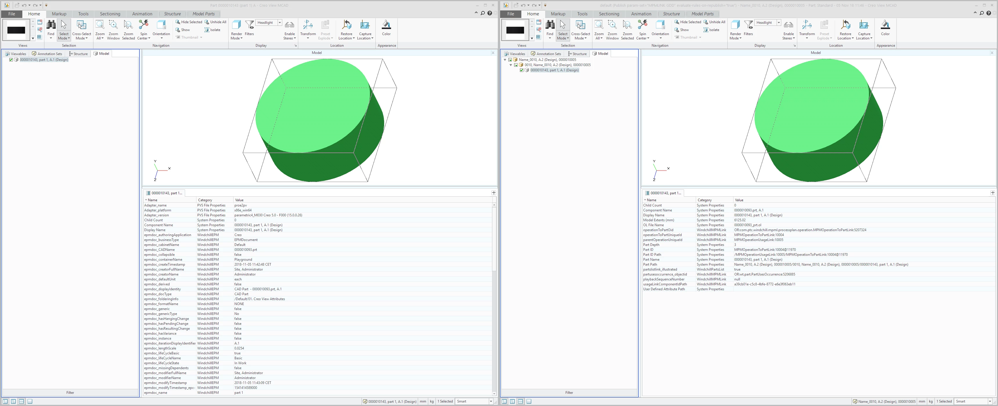

I am implementing Windchill MPMLink (11.0 and above) at several customers at the moment,
And there is a need to display custom attributes in the Work Instruction Illustrations.
I have noticed, that custom (Creo or PDM) attributes are not being copied to the Operation Viewable.
I have attached a screen shot showing the available attributes for the same part.
The behavior is the same for both Creo View and Illustrate representations.
I suggest that there should be an rcp file or some properties to control the behavior of operation viewable creation (i.e. the adapter/loadAttr=1 row of an rcp file).
Any idea where to look for a possible solution will be appreciated.

Hi
have you call the Tech Support for that ?
If it is the " normal" behaviour, you should open an idea/enhancement and I will vote for it .
If you have a solution,please post it, we will be interested of !

I have an open support case (actually 2 cases) since like forever (6 month and counting) for this issue.
So far no positive response from TechSupport/RnD.
I will share the solution if there will be any,
But I don't think that there will be any response in the next years to come, given the quality of PTC Support.
