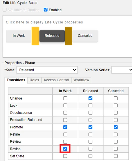

If you need to crate new downstream branch you need to have rights to revise the Released wtpart and also the Released state needs revise transition in Lifecycle definition.
So first you need access to crate new view for Released objects and I guess also revise. I would recommend to cooperate with Windchill administrator to play with ACLs.

It is usually connected with ACLs. You need to have privilege to revise , create new view version and modify the WTPart for specific state.
Try to create Manufacturing WTPart in a folder system and check access on it. If you do not access to do so you need to define ACL in Policy Administration.
Additionally: A LifeCycle state also needs to be defined with Revise transition to create a Downstream branch in the transform browser with a duplicate with propagation.

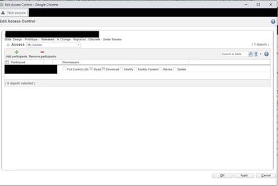

When I create a part with a view set to manufacturing I have a full access in its action control.
However when I choose any WTPart i get these privileges:
Could you elaborate a little further on the LifeCycle state definition, please?
Edit:
Here is a detailed view:
Which access controls should be available to me in order to perform all of the necessary eBOM->mBOM transformations?

I can see that WTparts are in a Released state so you do not have rights to modify it. It is ok.
ACL Definition
