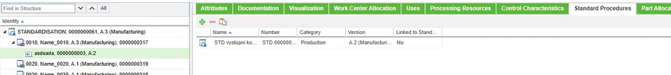

MPMLink Standard Procedures tab buttons grayed out
We're just getting started with MPMlink... wondering why the Standard Procedures tab buttons for insert and paste are grayed out.
In instructions it says we can use the Uses tab and insert an existing standard procedure for there. Sure. But it also says (a little it higher up in the documentation) that :
Is this a preference setting or something else?

The manufacturing license is assigned to the user. We can insert an existing standard procedure via the Uses tab. It's just the standard procedures tab that is grayed out.

The Standard procedures works just with a Control Characteristics
Select the control characteristics in the structure then the plus button is active
