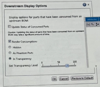

MPMLink Viewing Consumption Status missing in WC12.0.2.8?
In Windchill 11 -  when doing eBOM/mBOM transformation - there was an option to view consumption status. You click a part from the visualization window and it disappears or turns translucent to represent consumption.
In Windchill 12 it seems as though the "Render Consumptions" button is missing?
And in the documentation there's a former link (guessing by the font color) MPMLink Visualization Panel that would in theory answer this, but the link is no longer active.
Has this functionality moved somewhere else or is it no longer available?

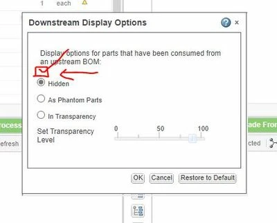

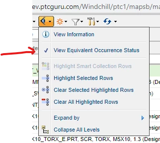

Have you tired the following
Once that is selected then the graphics in the visualization tab update as expected.

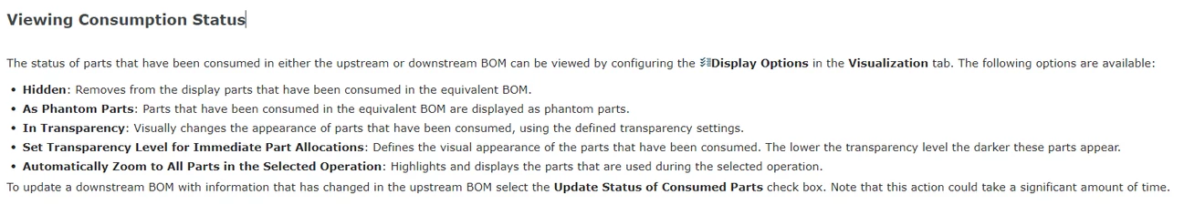

It is not a link it is just information to read an paragraph that is located bottom of the page

@HelesicPetr I did take a look at the bottom section as well. According to it, I ought to see a Update Status of Consumed Parts that is missing in WC12.
Dobi
Dobi17-PeridotAuthor
Mar 2, 2023 6:24 PM UTC
That was it! Thank you 🙂
