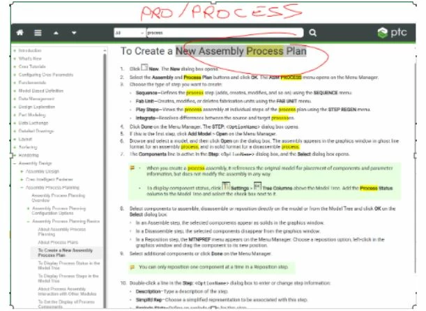

We have been using Pro/Process for instructions in many years.
Creo is interrupted when editing steps.
PTC told me Pro/Process is not longer supported.
Is Pro/Process the same as Assembly Process Plan ?
Is Assembly Process Plan supported ?
