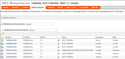

multi view part shows duplicate CAD drawings in related Objects
We have a multi view part with Owner association to the .drw.
In the first view, the related objects shows the same drw version 4 times

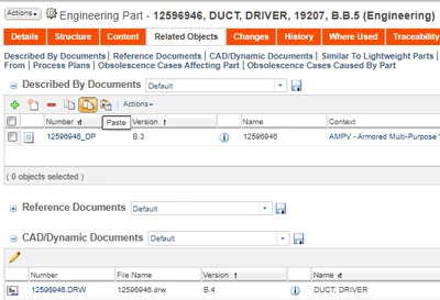

On the later view, only once.
next downstream view:
Any idea why it's doing this?
We just happen to have four revisions, is that a coincidence?

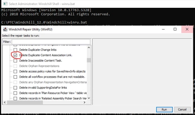

There are duplicate content links created.
With 2 links Windchill shows linked drawing 4 times for some reason.
Run WinRU.bat to automatically delete duplicate content links:

Feb 14, 2024 2:28 AM UTC
Kind regards,
Dmitry
Feb 15, 2024 6:10 PM UTC
@DmitryC that worked, Thanks.
