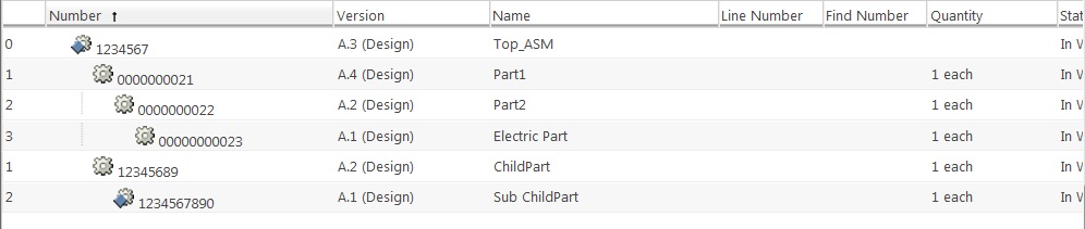

Hi All,
my requirement is to get Multilvel BOM from Windchill using API.
i have below code which gives me only the child parts from first node in assebly.

I Pass the run time Argument to this i.e my TOP Level Asm Number: 1234567.
it gives me output::
Inside the Main Method
Inside the getPart() Method::wt.part.WTPart:96042
#########Something here!!#######
Inside the ArrayList getPartList() Method[wt.part.WTPart:96042, wt.part.WTPart:96050, wt.part.WTPart:110026, wt.part.WTPart:110037]
pList size: 4
1234567
0000000021
0000000022
00000000023

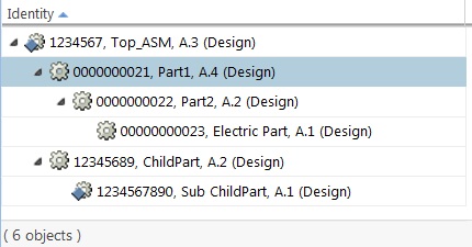

Here is the my BOM Snap from Windchill.
and below is my Requirement
Please check my code and suggest the modifications so i can get my required BOM.
Vivek

Hi vivek,
I am running your same code in eclipse .but only one part is displaying.sub parts are not displaying.Could you please help me what is the mistake in d code .I need to rtrive all the sub parts of part means all assembly.
Sandeep
July 29, 2014
Hi Sandeep,
Use this code
public static void getChildParts(WTPart parentPart) throws WTException
@SuppressWarnings("deprecation")
QueryResult queryResult= WTPartHelper.service.getUsesWTParts(parentPart, new LatestConfigSpec());
while(queryResult.hasMoreElements())
WTPart part=null;
Persistable[] persistable=(Persistable[])queryResult.nextElement();
part=(WTPart)persistable[1];
WTPartUsageLink partLink=(WTPartUsageLink)persistable[0];
System.out.println("ParentPart :-" + parentPart.getName() + " ChildPart :- " + part.getName());
getChildParts(part);
Kaushik
August 26, 2014
Thank you its working
