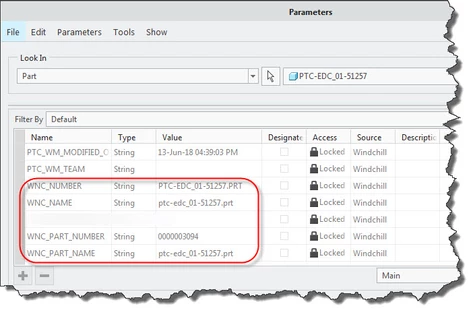

I would use creo parameters from windchill with wtpart number in the repeat region
PTC_WM_PART_NUMBER
PTC_WM_PART_NAME
check following articles
https://www.ptc.com/en/support/article/CS18803
https://www.ptc.com/en/support/article/CS287504
