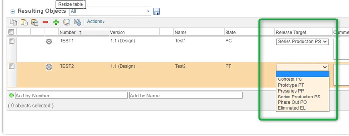

I am using Windchill PDMLink Release 11.0 and Datecode with CPS M030
I am trying to get the functionality of Multiple Release Targets and I am trying to Migrate into Windchill 12.1 and would like to get this functionality working before I move to Windchill 12.1, I have added the a new life Cycle state and still does not work. All I want is for the pull down to happen when you want to select on e of the multiple Release Target states. Please help me get this running so I continue my migration.... TY Bill H. PS I realize we are at Windchill 11.0 but I see in Windchill 12.1 it has the same functionality but want to see this operate before I bring the database across. I don't want the new system to be un available.

    Hello @wharaden1
    First you need to allow the Multiple Release Targets by preference for example on site/Utilities/Preference Management.
    If you need your custom state as a target you need to modify the LifeCycleTemplate and use some of transactions which are allowed in Change process
    CHANGE,PRODUCTION_RELEASED,OBSOLESCENCE
    In change task and selection Release Target State you always see the transaction name (not target State).
    If you need that the option name should be same as target state, then you need to customize transactions a way as you add custom lifecycle state but you chose transaction.rbinfo file.
    Add new transactions to the list of allowed released target transactions in wt.preference
    wt.change2.changeTransitions
    default value is "CHANGE,PRODUCTION_RELEASED,OBSOLESCENCE" (I would check it in your system)
    in the windchill shell run xconfmanager tool to change this property with your transactions that equals to your states.
    After restart server you can use transactions in your lifecycle template.
    I use it several times that users do not care what is change, ProductionReleased options and they just chose correct name of state in change task.
    Hope this general description can help.

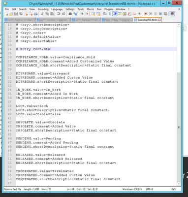

    Hi Petar,
    I found my TransitionRB.rbinfo file.
    It looks like this:

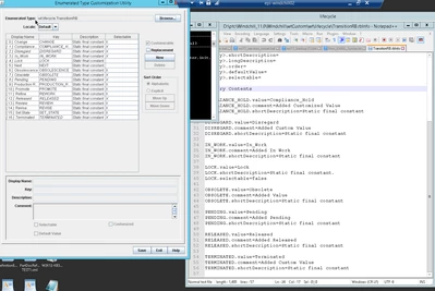

    Here is what my EnumCustomize looks like:
    Don't these have to equal or if you have some instruction on what to change please.

    Apr 19, 2022 6:39 AM UTC
    Hi @wharaden1
    If you edit a rbinfo file you need to run ant makejar script after a save in the enumcustomization wizard .
    makejar propagates changes to the Windchill.
    from Windchill shell run following command:
    ant -f codebase/MakeJar.xml
    Stop windchill
    clear tomcat cache
    Start Windchill

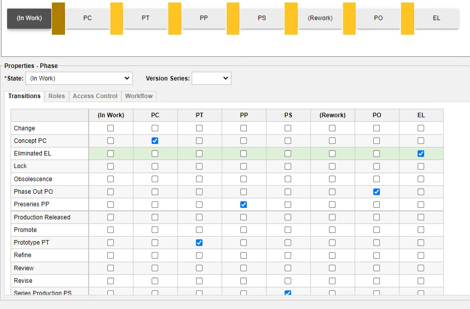

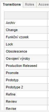

    After that you should see the transitions in a LifeCycle editor

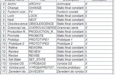

    enumcustomization editor
    wt.properties (used internal name)
    LifeCycle editor with transitions
    The result in Change management SetReleaseTarget with multiple transitions
    LifeCycle of an object
    Hope this can help.
    PetrH

    HelesicPetr
    May 18, 2022 5:36 AM UTC
    Hi @wharaden1
    Where's the trouble?

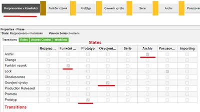

    Can you see transitions in a LifeCycle template edit wizard? to be sure that custom transitions are there.
    Do you set LifeCycle template to use the transitions? You need to set the transition for each target state.
    PetrH
    Nov 23, 2022 11:07 AM UTC
    Dear friends
    This post made my day!
    With its help and the reference to CS124047 I was able to enable Multi Target States for change messages in an important customer project!
    Many thanks for this
