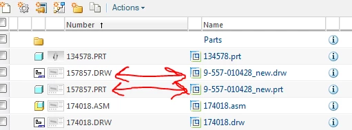

Is there a way to get like a full system report if there are any differences between the Name and Number of an item?
We are using Windchill 10.0 M030 and most of our items are matched up, but a few of them have contradicting Names and Numbers. I would like to know if there is a way to get a list of all the items with discrepancies?
Attached it what I am looking at trying to match up.
Thanks for any help!

I think this SQL Query will return what you want.
SELECT
DISTINCT EPMDocumentMaster.CADName "FileName"
,EPMDocumentMaster.name "Name"
,EPMDocumentMaster.documentNumber "Number"
,WTUser.name "Created By"
FROM
EPMDocumentMaster
,EPMDocument
,WTUser
WHERE
EPMDocument.idA3D2iterationInfo = WTUser.idA2A2
AND EPMDocument.idA3masterReference = EPMDocumentMaster.idA2A2
AND (
LOWER(EPMDocumentMaster.CADName) != LOWER(EPMDocumentMaster.name)
OR (
LOWER(EPMDocumentMaster.CADName) != LOWER(EPMDocumentMaster.documentNumber)
AND EPMDocument.statecheckoutInfo = 'c/i'
ORDER BY
EPMDocumentMaster.CADName ASC;

Mar 5, 2014 9:45 PM UTC
Thanks Joe,
I'll check out how this query works.
