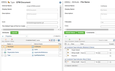

the 200 string length constraint is locked, i have created a new one but it does not help:

Jan 10, 2024 12:15 PM UTC
This is a database column constraint. There was an discussion about someone wanting to increase this a few days ago:
https://community.ptc.com/t5/Windchill/how-to-extend-name-field-of-WTDocument/m-p/921801#M77106
BTW, the image you showed filename. That is not the same as name field which is more for descriptive or a object's title.
Don't recommend you muck with this. 200 characters is more than an old style tweet. @mmeadows-3 is right that if you want to write a novel, use an IBA.
