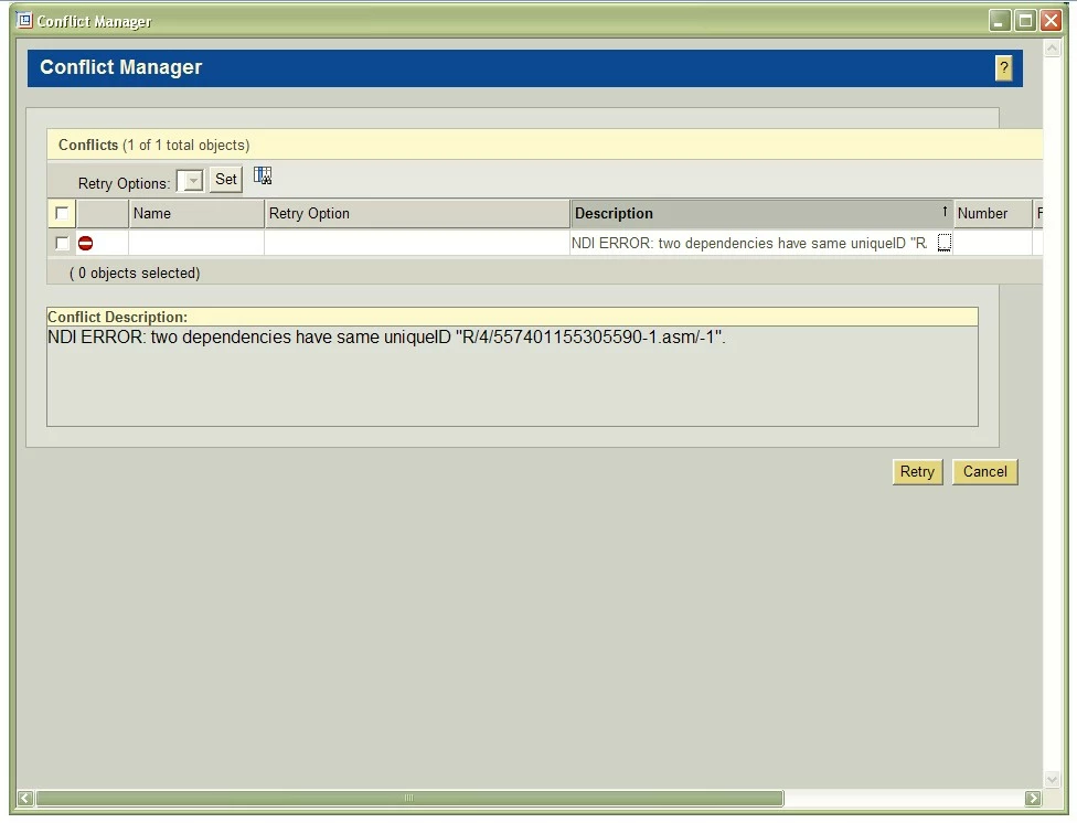

NDI ERROR?
I have a user that is getting a NDI ERROR while trying to while trying to upload a assembly with a family table.
The error is "NDI ERROR: two dependencies have the same uniqueID "R/4/FF7401155305590-1.asm/-1".
Would the "R/4" refer to the "fourth row" of the tabulation?

Aug 19, 2011 12:20 AM UTC
May be Revision/Iteration/Name

Apr 2, 2014 2:41 PM UTC
Hi, Could you please develop your answer.
I have same problem. I don't understand what I'm going for resolve this error
Feb 19, 2015 3:45 AM UTC
This is know issue due to incorrect dependencies of CAD data saved into PDMLink, Please try the PTC CS103697 resolution.
https://support.ptc.com/appserver/cs/view/solution.jsp?n=CS103697
