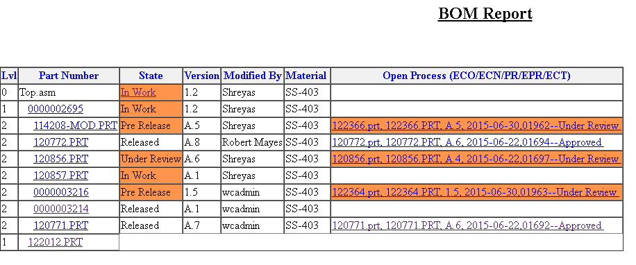

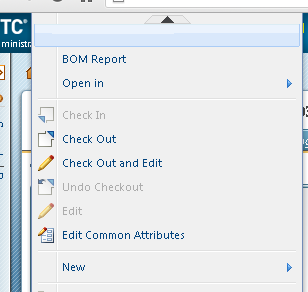

To get the multi level bom report with SQL query is very difficult(impossible ). However without using congos you  can create the reports. I have created some BOM report without using windchill API and JSP, to list MBOM, some attribute and current open process for all parts
attached sample java class contain useful API's
Let me know if you need more information
Shreyas
