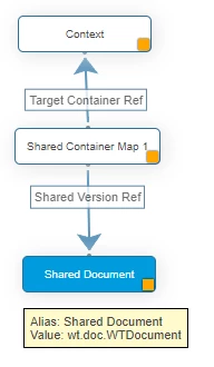

Need get the version when part shared to project, not the latest version
I am using Windchill PDMLink Release 11.2 and Datecode with CPS 11.2.0.0
I need to get the part shared to version, but I tried every api, I can only get the latest version. I will post the qml file for my report emplate, and the information I want to get in the attachment.

This might be helpful. In this example, "Shared Document" is an alias I've applied. It's actually a regular Document, as I wanted to report on documents shared to a specific Project. I have a constraint where I set the Context Name to the name of the Project that I want to report on. This should return the specific version that has been shared.
