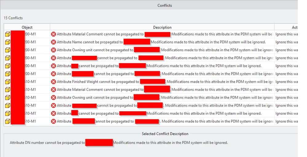

Hello everyone,
I need some help with this problem, PTC is responding with the usual "Works as intended".
I'm trying to find a workaround for this problem (See video)
The current problem we have:
Attributes with illegal (Spaces and"/" were used) characters were created in Inventor, we are now using these inventor file in Creo parametric (Creo unite allows us to do this).
The result is the propagation error.
We have hundreds of users receiving a lot of errors when opening assemblies.
Is it possible to automatically implement the ignore option?
Or even better: skip this useless check on Inventor files?
We already have the following solutions, but they are not suitable for us
- Hide all warnings (Also hides useful warnings)
- Rename all the inventor attributes
Sincere
Alex

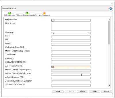

Do you have to map this to Creo as well?
In your video, you did not map this attribute to a Creo attribute.
May 8, 2023 12:35 PM UTC
No this is not mapped to creo, I don't think this is required.
If no mapping is available then the implicit parameter "R_S" will  be used?
Also a side note, Creo automatically transform the parameter R/S to R_S in Creo parametric. This is fine for us but we need a solution to hide the propagation errors.
