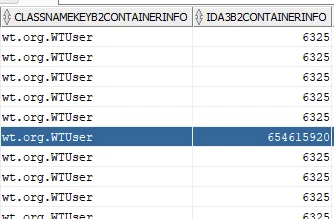

If its not something in the UI, you might have to resort to a database edit. The creator for the Library is stored in the WTLibrary Table. Modeled Object info shows this as the ida3b3containerinfo column.
You need to get the ida2a2 value of the user you want to change it to and copy that number for that library's row. I also think it has to be a real user account, not a group.

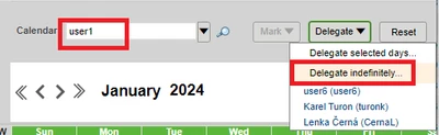

Use a delegate calendar and delegate all work to an another user
Emails could go to delegated person.
Also if the user is not part of the company you should follow recommended process to disable that user.
For example change users email, name for example add a disabled prefix to a name. fullname atc....
How to deactivate/disable inactive users - CS136420

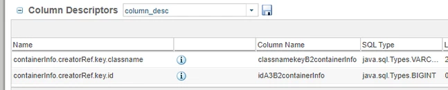

First question, how did you get to the Column Descriptors (like the image shown). That could be a very useful tool.
As for changing the database, can that be done from something like Windchill Shell? Or, would I need direct access and permission in Oracle/SQL?

https://<your  server name here>/Windchill/app/#ptc1/carambola/tools/list
then go to Modeled Objects.
You would need direct access to the DB. I was using SQL Developer to browse the tables and you can make edits. Careful careful careful with DB edits.

Not Part OOTB , you can give a try and change it using SQL after taking a backup of given table  , the IDA3B2CONTAINERINFO column ,stores the ida2a2 of the product/library creator .
