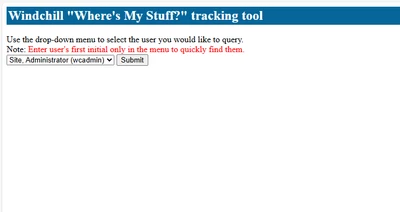

I did write a customization back in WC 8.0 nick named "Where's my stuff?" The tool was run from Quick Links menu.
This tool can be customized to whatever is desired, but I think the logic I used is a good starting point. Read on.
A page opens that listed all user alphabetically but default the current user, the user running the tool.
Upon submit it finds all valid ChangeRequest, ChangeOrder and PromotionRequest where the user was the Submitter or Creator or whatever role you want.
Valid meant the state of the object was not Resolved or Cancelled or Rejected.  You get the idea,

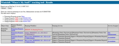

A table is then returned to the user displaying the process and the running robots (Synch, Expression, Activities, Method Robots) and the state.
If the active robot was an activity the user holding up the process was also displayed.
Everything displayed included hyperlink to the displayed object.
