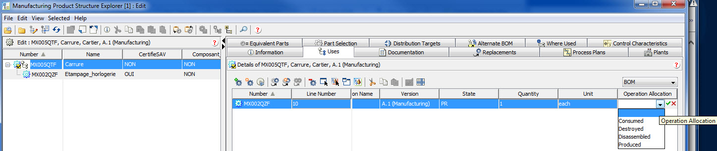

If you have MPMLink, there's an attribute on the BOM usage link "operation allocation" , where you can choose "disasembled or, produced" ...
in that case, Windchill, and notably ESI will set the quantity as negative in the release message to ERP ....

Is anyone actually using this functionality?  When I try this, the ESI response is not rendering the parts or BOM and the operation to part links are all positive quantities.  I'll put in a ticket in the meantime, I'm just wondering if I missed some configuration point.
