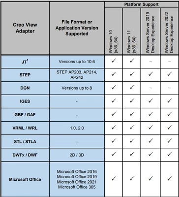

The other confusing bit with the Creo View Adapters 11.0 for Office specifically was Office compatibility documentation:
CS74838 --> 11.0.0.0
It calls out Office 365 there, but in the doc2pv.pvi it explicitly DOESN'T mention Office 365 (but does call out the other 3 supported versions). Given that the WGM/Windows Server version sensitivity was so high, I was expecting this worker to have more trouble than it did.
